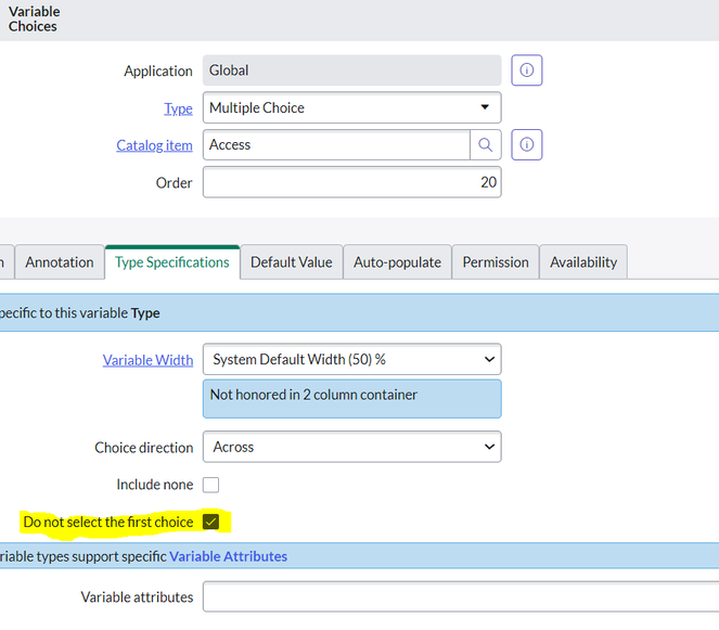

Hi @Ankita NA
Can you please check the "Do Not Select the First Choice" and check it again as shown in snip below :

Hi @Ankita NA ,
Could you try selecting the below option in variables Type specification ?

Hi @Ankita NA
Reason for this the value of Dont Select First is Uncheck. Please mark it true and test again. or why you not make it mandatory so that user must select.
