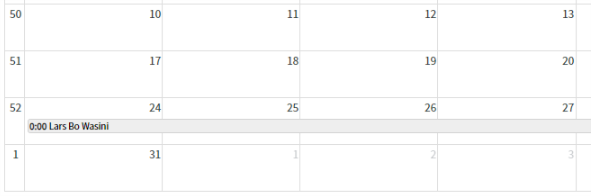

I have created a new table with 3 fields: Title, work_start, work_end and the created a calendar report:
Now I have 2 questions:
1: How do I remove the "0:00" time?
2: How do I change the gray color to another color.
I have read the "Customize calendar reports" in ServiceNow documentation, but I can't see anything about this.

09-26-2018 01:15 AM
1: I already have tried this, but the time is added as default.
2: I have tried to add a background color for every field (including sys_id), but this doesn't change anything. Except that my form now looks like a piece of candy.
glide.ui.report.extend_calendar_choices is set to true
