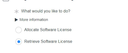

Hello community members,
Does anyone know if there is a way to display different help text based on selections made on a multiple choice variable? I have text now, but it displays the same no matter what choice is selected.
