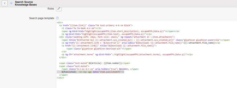

The published can be changed from search sources for knowledge. If you replace the highlighted line below then it should be fixed.
${Published}: {{item.publishedUTC}}
Hi Gurpreet, thanks for replying but i tried changing the published as mentioned by you but its not working, its still coming the same way. I even got a script include KBPortalServiceImpl, but i am not sure what changes needs to be done there. Can you please help me with this? I am not sure how to move further

You are possibly using some custom widget for this but i tested this in pdi and its working as expected.
