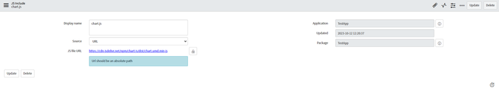

i want to use ChartJS 4 inside my Widget. However, the following bug occurs with the new version of ChartJS:
If i link the dependency with an URL it works just fine:
This works fineThis works fine
But i need to link my dependency statically with an UI-Script like this:
Suddenly the Chart stops working. The background with the metrics will still be loaded, but the values won't. In addition I get an "Can't read properties of undefined" Error in the browser console while hovering over the Chart:
I assume that the Error occurs from a bug in the Rhino interpreter, because there shouldn't be an undifined Error, since the library just works fine with URL linking?
Also the Problem did not occur with ChartJS version 2, just with version 4.
Does someone had similar problems including js libraries?
Thanks in advance
