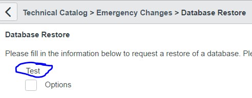

I have some checkboxes in a record producer and the text "Options" automatically appears.   Is there a way to get rid of that?

In Record Producer variables you can notice Options as a type label, if you want to get ride of this you can uncheck the active.   please look into below screen shots.

If you want to keep it as blank try using   a space in Question field ,it will accept the empty space (pressing space key once) and so that you can get rid of the label that is showing up
