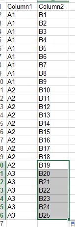

My custom application will be used by three different end-users. Lets say X,Y and Z. X fills up the form and Y and Z approves it .
Attached screenshot is the choicelist. Form will process the column A but end-user X is aware about the data in column B. Approval by end-user Y and Z will be based on Column A's value.
Suggest me the best datatype to add it to custom table.
Something similar to the "Reference" field in "Dictionary definintion" when we choose reference as data type.

While making the choice, user may need the data in other columns for reference. Is there any suggestion to show it up in some other means? Like another label field?
