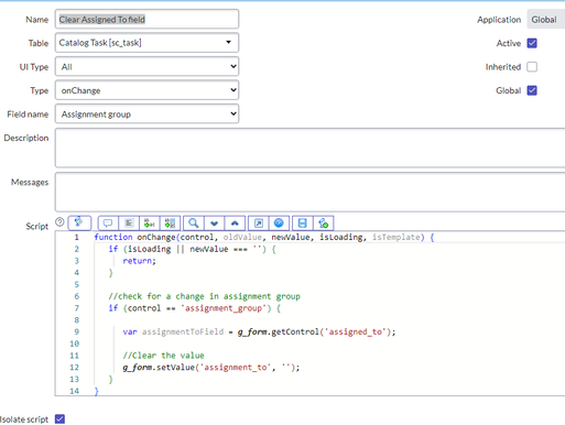

04-19-2024 03:06 AM
any ideas why this does not work? when i change the assignment group, the assigned to remains the same
