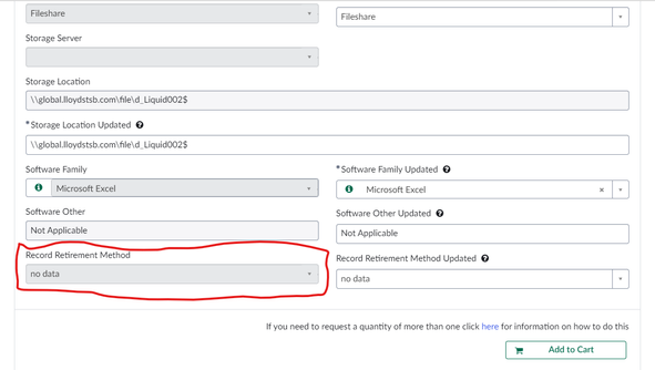

I'm trying to create a client script for a catalogue item if certain values appear in the previous field:
 In the above example, if the 'Record Retirement Method' field is set to 'no data', then I want the 'Record Retirement Method Updated' field to be cleared out. I've written the below onChange client script to get other fields working the same way:

If somebody could explain where I'm going wrong with my client script, that would be much appreciated.

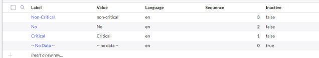

Hi @Brad Bowman   This is the list of options:
So I'm taking the label from the 'Value' column and applying that to my client script.
Hello, i dont think the choice value will return "--no data--", it must be "no data". Can you keep a alert in your client script to check what value the script is returning like below?
var getSupportcbp = g_form.getValue('support_cbp');
alert("choice value"+getSupportcbp ); // check here whether you get '-- no data --' or 'no data'
if (g_form.getValue('support_cbp') == '-- no data --') {
g_form.clearValue('new_support_cbp');

It's best to avoid spaces and extraneous special characters for values as a general rule.  In any event, this choice is inactive, and your script is using 'no data' for record_retirement_method, so what is the value of record_retirement_method when euc changes?
