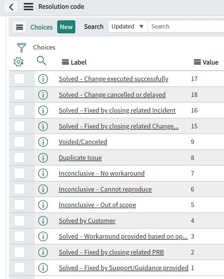

Dear experts,
I've tried to use "Dependent fields/value" to make some choices of the "Resolution Code" field become available or hidden, based on what category my Case (CSM) is on.
I found through posts like Add multiple dependants in field for Choice - IT Service Management - Question - ServiceNow Communit... that you cannot add multiple dependants for a choice, which is what I require.
Since I am not yet proficient in scripting, I was hoping someone could help me write a client script that does the following:
  • When Category is set to choice "Normal Change" (value 6), show "Resolution Code" choices 17 & 18 (values)
  • When Category choice is set to anything else, show all other choices (0 4 3 5 7 8 9), except 17 & 18.
I tried to leave the "dependant value" empty, but this only resolves in the other choices to show when Category is set to "None". Hence I figured I need a client script! I see however many warnings about client scripts; will this be impactful on our performance and hence not-advisable? Are there any alternatives?

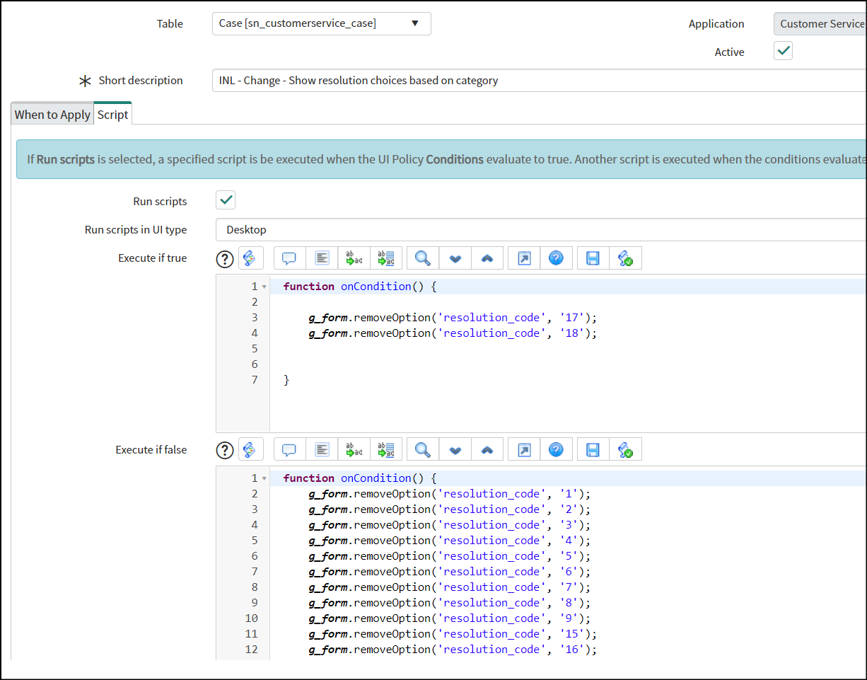

Dear Pavan,
Thank you for the suggestion! I've created the UI Policy with the script you gave me, but even though it seems to work on initial load, as soon as I change the category, the resolution codes come up empty.
(By the way, I noticed you used 'category' in your script, which removed category options. I changed this to 'resolution_code')
I hope you can point out the mistake I made!

On UI Policy form you can uncheck the On load check box it will executes like onchange.
Hope it helps!!
