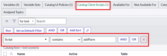

Hi @dvass0107
Have you checked the other client scripts as well?
  • Carefully search the entire form’s Catalog Client Scripts for any addParm or any GlideAjax variable named gax.
  • It may be in a different script (onChange for another field, onLoad, etc.).
  • Fix any instance of addParm to addParam.
Hope this helps!
