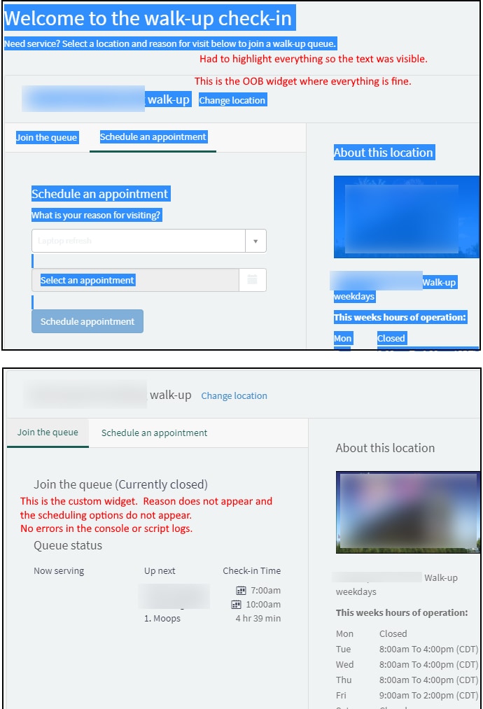

We want to add an option for people to reference an existing task record as part of their appointment scheduling so I need to edit the widget to give them that option.
- I've clone the widget Online Check-in Experience.
- I've created copies of the 8 ng-templates and renamed them.
- I've created copies of the 4 angular providers (directives) so they can reference the updated templates (templateUrl).
- I've looked for any "ng-include=" that needs to be updated in the HTML and updated all the inline directives.
- I've scoured the client and server scripts for any references to the original templates or directives.
And for the life of me, I still cannot get the dang widget to render properly. The "reason for visit" select box template will not render at all on the page and the Scheduling widget does not render correctly (or at all) either. The hours, location, and *parts* of the away messages do work fine.
Before I went as far as creating copies of the directives, if I had BOTH the custom widget and OOB widget on the page it *seemed* to work fine except some console errors about duplicate ID's, which is no good.
Has anyone actually been able to clone this widget and get it to work? What am I missing that the reason select box won't render and the scheduling widget call won't work? I did *not* try and clone the scheduling widget and it is using OOB.

I opened a HI ticket about cloning the widget and what could have been missed. That resulted in our dev instance being rebooted. After that everything seemed to start working. I was able to confirm these steps do work in an entirely different instance.
