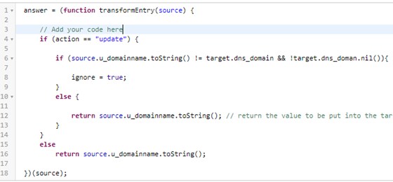

My Transform Map for Netgear CIs mapping looks as below,
Field Maps : ( Do I need to still specify the coalesce while using the CMDBTransformUtil API call ? )
To compare existing values, i have the field level script on each row map
