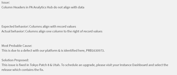

I am seeing same issue. My issue is not the what Manmohan has outlined. I have opened a case in HI and they responded. with the following:
I am running Tokyo Patch 7 at the moment. We are upgrading to Patch 9 next week so I will be able to see if it is really corrected.
I have just checked our upgraded instance (glide-tokyo-07-08-2022__patch9-05-10-2023). The column headers are now aligned to the Record data. The upgrade looks to have corrected the issue for us.
Many Thanks for sharing this James. Yes you are correct, I am still having exactly this issue on PA Analytics Hub and have not been able to resolve this.
My Client's instance is currently on Tokyo.
