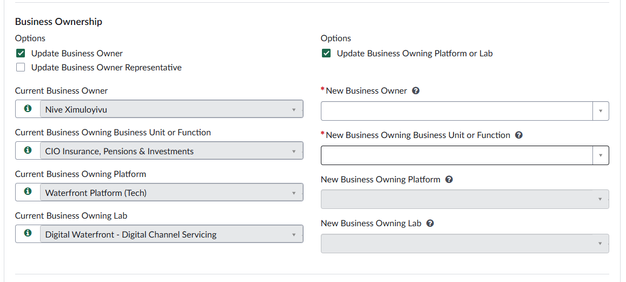

I've got a catalogue item where a user can input new different departments into an existing business application:
What I'm wanting to add is check if the path to the current Business Owner's department aligns to the proposed Business Owning Business Unit/Function or Business Owning Platform. If it doesn't then inform the user that the current business owner does not sit within the proposed Business owning Business Unit and/or Platform.
The 'New Business Owning Business Unit or Function' displays options where the Department type is 'Function' or 'Business Unit' and 'New Business Owning Platform' displays options where the Department type is 'Platform'.  I was just wondering if anyone has come across this before or something similar.
Generally, a a department with a type of 'Platform' is usually a child of a department with a type of 'Business Unit' or 'Function'. However, though, it can sometimes be that the grandchild department has a type of 'Platform', the parent department has a type of null, but the grandparent has a type of 'Business Unit' or 'Function'
