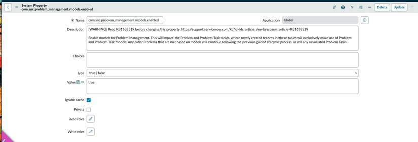

11-19-2025 08:51 AM
Hi @abhilashsg
Instead of adding the task type, it’s better to use the Problem Task Model. For that, you need to enable the problem model.
I have already configured the problem task types (prb_task_model), but they don’t show up here.
Atul: Did you enable the property to view the problem models? please check.
Otherwise, if you want to go ahead without the model, then follow these steps.
- In the navigation filter, enter sn_sow_interceptor_record_type_selector.list.
- From the Record Type Selectors list, select New.
- On the Record Type Selector form, fill in the fields.
