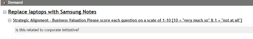

Ultimately my goal is on the nice display page is to use the Demand Name instead of "Demand" in both locations so that stakeholders.. you know.. know what Assessment they are about to take. I think I should be able to figure it once I can find it any help of course is appreciated!

I have checked out both of these tables and neither store the name of the Demand or have a link to the dmn_Demand table where the title of the Demand is initially stored.   Eventually the name of the Demand is saved as a Task and can be found in thge Task table - but again i am not sure of the key that will allow me to access it.
When you launch the actual Assessment at the top of the tree it has the name of the Demand, but I think I have found the UI script that builds the Assessment form (assessment_take2) but I am unable to determine how/where it retirives the name of the Demand.
If you attempt to submit an uncompleted assessment then you get this error
and I have been able to trace it back to the 'assessment_take2 - client script.
I can trace 'assessbaleLabel' back to
But this where the trail goes cold!
