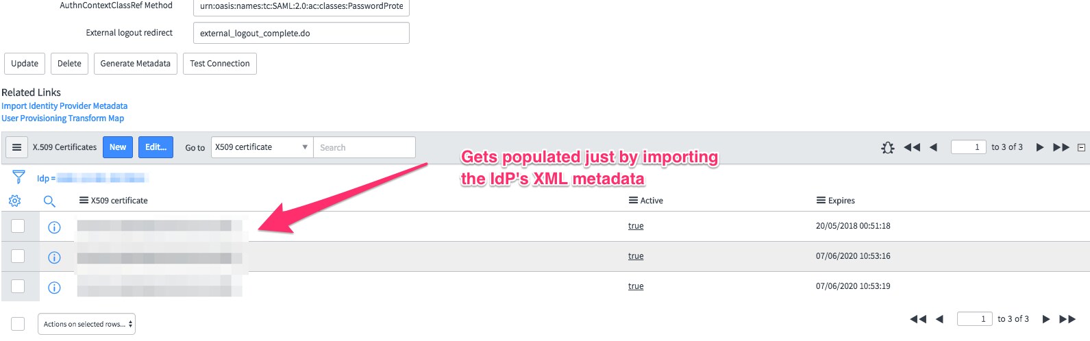

Something else I'm confused about though - in the Multi-Provider SSO, Identity Providers record, is it actually necessary to manually import and assign the certificate under the "x509 Certificate" field?
I've noticed that the PEM format certificate appears to be included in the XML metadata export from the IdP. I have one customer who's SSO is working fine, and I didn't import a certificate for them. Just importing the XML file populated the X.509 Certificates related list at the bottom of the record, even though the "x509 Certificate" field itself is blank.
