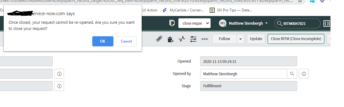

I call the action "close_ritm" which was a UI Action I built based off of the "close_sc_task" UI Action. Inside of this UI Action, I have a confirmation message:
For this, I am using if(confirm"My text here"); on the UI Action. This is working fine here, but does not apply to the Service Portal when using the newly created "Close Request" button. I thought this called the same UI Action. Is there something I can add to my widget which will do something similar to the UI Action? Guessing it needs to be on the client script but I do not work much with widgets on the Service Portal...
