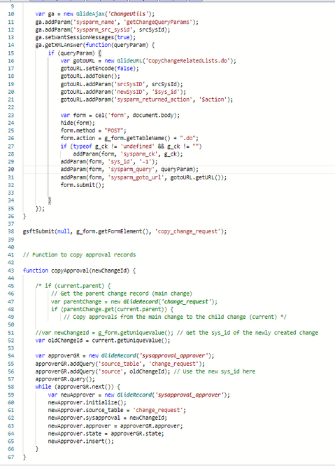

@piyushsain
Sorry for the long reply. I tried the solution you proposed but it didn't worked for me. Can you please check and let me know what wrong I did with the below code. Approval records are not copying to the new change record. You need to create a field in Change request which can be hidden and read only , for example "u_copy_from". I didn't tried this but insted I written the server side script in UI action it self. If possible can you please check the below code where is my mistake.
