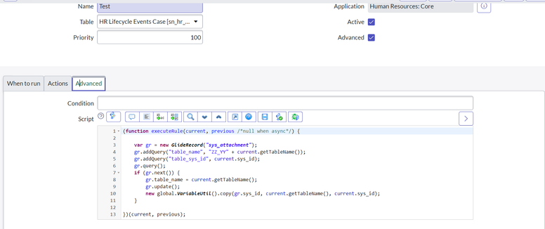

09-12-2023 06:35 AM
Hi Ankur,
How can I remove ZZ_YY before copying. I written this business rule
Async - insert. it's not working. can you help?
If I remove this zz_yy from sys_attachment manually from the table then it's adding the attachment on the case.
