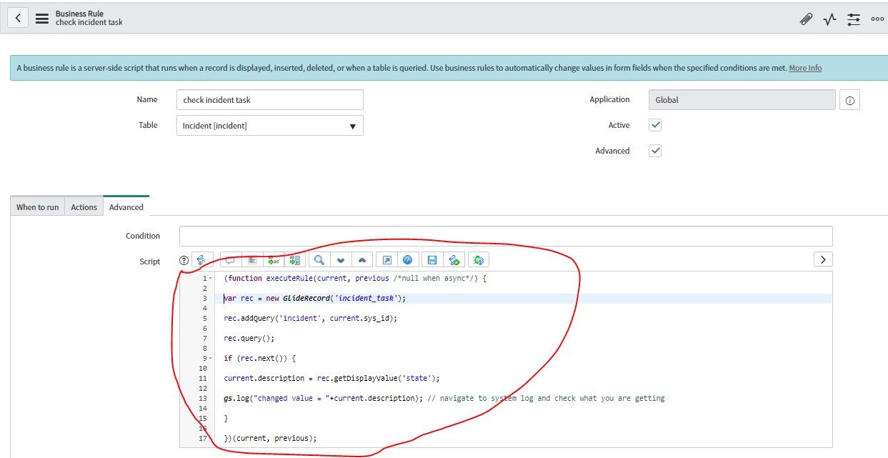

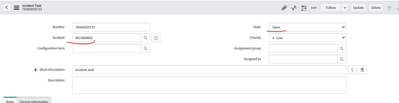

Hi Arun,
I tried same in my PDI and it is working properly.
Check attached screenshots.
Business Rule -
Incident task record -
Incident record after resolved.
See result in log
Dhananjay.
