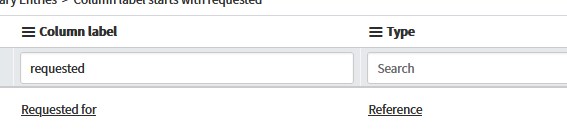

I have an issue where some workflows do not fill our the REQ requested for but will fill out the RITM requested for. There is more than one workflow so I was looking to create a business rule to catch all of this.
You can see below the request.requested_for is not populated.

04-19-2022 08:53 AM
I thought there was an OOB field for requested for on the RITM table? I have one that does get populated and that is what I am trying to copy to go into the Request requested for.
The field name is requested_for and this is on the sc_req_item table.
