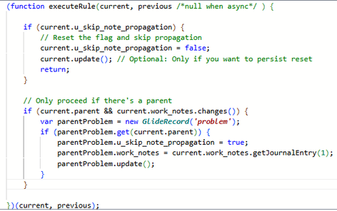

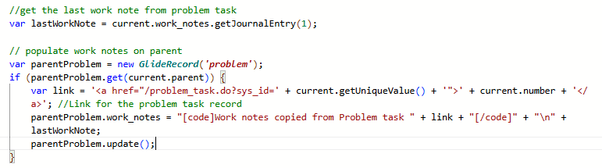

05-16-2025 12:23 AM
Hey,
This is my current logic inside BR, after update:
where should I integrate the first idea so it will work and prevent recursive copying?
Elena

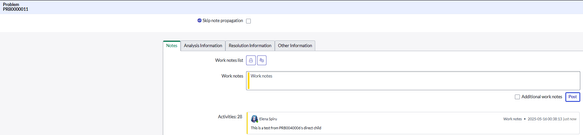

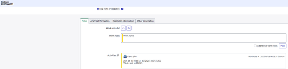

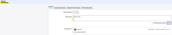

05-16-2025 12:41 AM
Also, I adjusted my logic with the second solution but this works up to a point. Added the new field on the problem table and this is how it looks with actual data while testing it:
Problem PRB0040006 is the parent of PRB0000011
Problem PRB0000011 is the parent of PRB0040031
So:
Adding a comment in PRB0040031's work notes copies into the PRB0000011:
This got copied correctly, only to its direct parent but the checkbox remains as true
So the issue now is that if an user adds a comment into the PRB0000011's work notes, it won't be copied to its direct parent PRB0040006, but it will change the checkbox to false
The updated BR I have:
Any ideas how to solve this issue?
Thank you,
Elena
