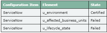

I need some assistance on creating a dynamic table from an array.
I want the configuration item to be a fixed header and the elements to be the custom headers with the state below.
The script so far and outcome:

results:
[{"configuration_item":"5a40ea6ddb56e680067450cbbf961921","element":"u_environment","state":"Certified"},{"configuration_item":"5a40ea6ddb56e680067450cbbf961921","element":"u_affected_business_units","state":"Failed"},{"configuration_item":"5a40ea6ddb56e680067450cbbf961921","element":"u_lifecycle_state","state":"Failed"}]
 Any advise on printing out on to a table would be much appreciated.

Apologies if I wasn’t clear  I was hoping to get format like this:
configuration item
u_environment
u_lifecycle_state
Certified
Failed
Failed
So each element will be the header and the state the value below.
