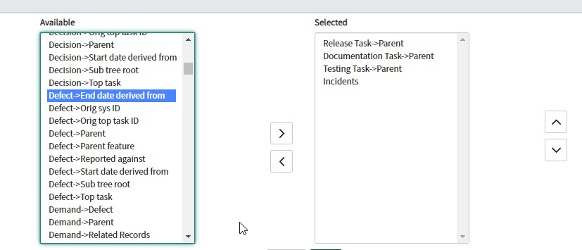

that is all working well, however, when I go to the defect form, I am not sure what related list I should be using. I found this post; https://community.servicenow.com/community?id=community_question&sys_id=9a0601dddb09db04032a7a9e0f96... where Sanjiv mentions to use Defect -> Incident related list, however, in our instance (and my personal developer instance) this does not exist.
I have also tried creating my own relationship, however, I cannot get that working either.
Does anyone know what I am missing here?

04-11-2019 09:30 PM
Thy this in your relationship record.
(function refineQuery(current, parent) {
var inc = parent.parent.sys_id;
current.addQuery('sys_id',inc);
})(current, parent);

04-11-2019 10:21 PM
You Rock!
That worked a treat!
Thanks, appreciate your help 🙂
