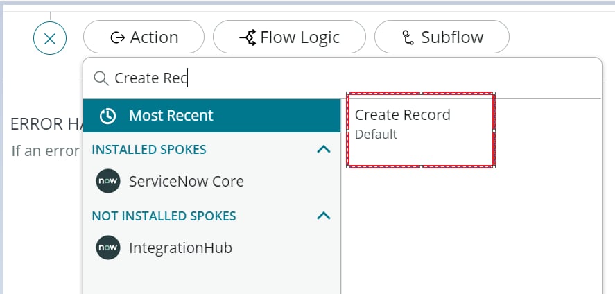

1.How to Triger a event via flow designer with syntax to define the event. --> Please make use of Action named as "Create Record" in Flow Designer as shown below:
Now within this action, fill out the details of your Event and this action will create Event Record in Event table which you can leverage to trigger your Scheduled Job using a Script action as shown in next steps below
