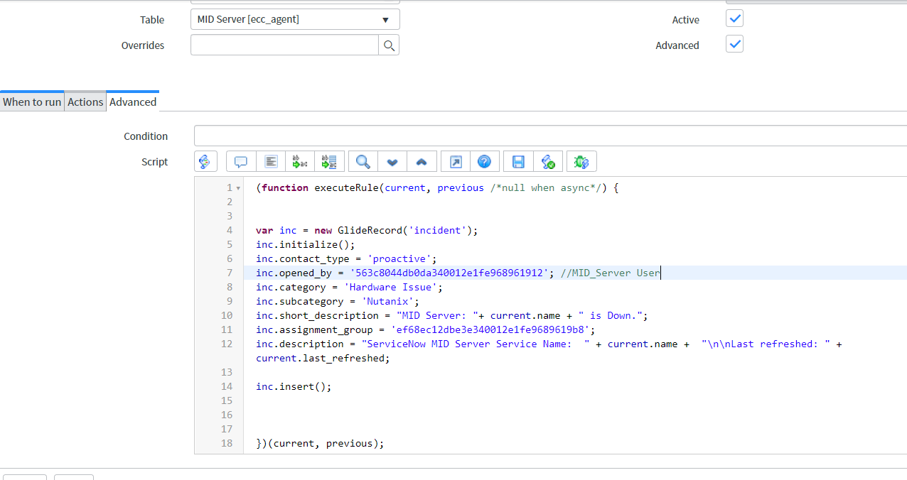

I created an after Business Rule to open an Incident when a MID server goes down which is working as intended.  What I am trying to accomplish is to modify its behavior so it waits 5 minutes before creating the Incident.
The ideal behavior would be:
  1. ecc_agent changes to down
  2. 5-minute timer starts
  3. At the end of the 5 minutes ecc_agent state is checked again
  4. if still down create Incident
Here is my business rule as is:
Any help is greatly appreciated.

Hello. Why not use a flow or workflow for this? Server status = down can be the start trigger then add a wait timer to see if server came back up. If not create the incident.
DScroggins
Thanks.  I didn't think about going that path.
