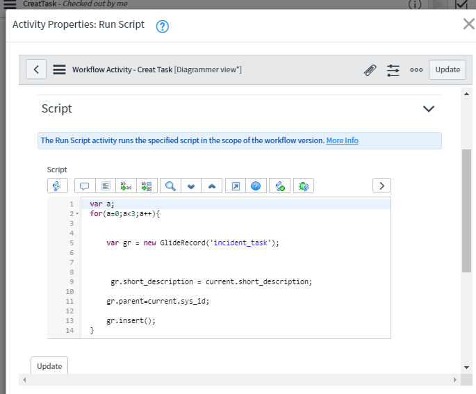

‎10-29-2018 05:52 AM
you can write script in Run script as below,and you will create record in any table.
Glide the table in which you want to create record.
as below i create incident task by custom table workflow.
in place of incident_task glide the table where you want to create record.
above code will create 3 task in incident_task.
if you face any issue the ask to me.
Mark correct or helpful if it helps you.
Warm Regards,
Pranay Tiwari
