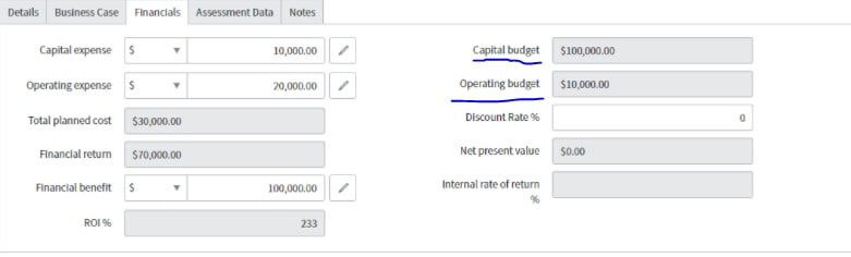

Hello all,
How to calculate the currency fields: Capital Budget and Operating Budget and summed of these fields should show in the customized field i.e., Total estimated budget.
For example: Capital Budget +  Operating Budget = Total estimated budget
                                    10       +              10             =                20
Any idea how we can achieve above scenario, i have tried using client script but not able to get the values of Capital and Operate budget fields.
Any help is appreciated!
Thanks in advance!
