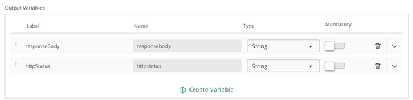

I have a custom action that runs a rest script. Part of the script retrieves a response body on execution.  That response body shows up correctly if I place it inside gs.info but if I assign it to an output variable the variable is always empty.  Anyone experience this? I’ve tried casting the response body to string.  I’ve tried parsing it.  No matter what I do - the output variable is always empty.
You should be using the name of the output variable.

Also without seeing how you're trying to assign the output it will be very hard to troubleshoot why it's not producing the results your expecting? One thing to check is to make sure you're assigning the script step output from within the script, and then the action output with the value of the variable from your script step.

And here is the output variables
And now that I'm posting this I think I see the problem.... My code uses the capitalization in the label.  Is the label what I should be using in the code?  OR should I be using the name which doesnt have the capitalization?
