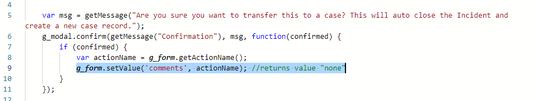

Either there is a bug or I do not understand where the association is being lost. But the fix is to directly call the action name rather than using g_form.submit(g_form.getActionName());. As a test I directly called my action name from the modal confirmation and it worked just fine. I went back and set the comment of the Incident to the action name that is called from g_form.getActionName() and it returned a value of "none".
Code snippet from my workspace client script.
Comment value in workspace.
