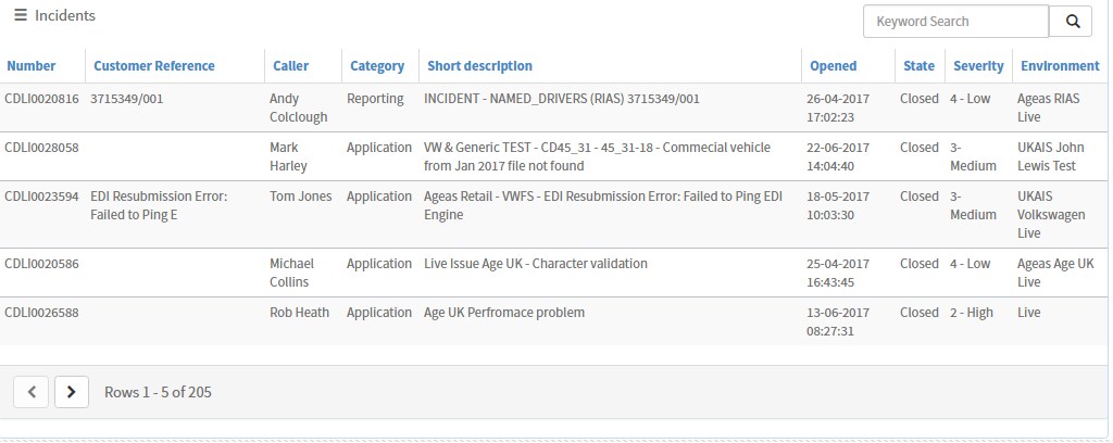

I have added 2 Data table widgets to a page on our portal.   I've added a filter to these and they are displaying as I am expecting.
I expected that when a log was clicked it would take you through to the ticket_field widget.   However if you select a log it does nothing.

Hi Rushit,
Thanks for the above, worked a treat - as you said seems daft to have to do this but least it works.
Sorry for yet another question - the title that displays on table is not the title I've selected in the options, is this something similar that needs amending?
Example:
I would like the title at the top of the table to be the title in the options, is this possible,
Once again thanks for all your help.

HI Rushit,
Just tried this, but doesn't seem to have worked.   When it first loads it seems to display the title I want for a split second then it reverts to the table titles:
