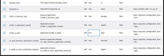

I was hoping for a screenshot, so I could see the prefix values. I see for the first entry "Impacted CI - impci_incident_alert = ia_sys_id" I guess the prefix for "Impacted CI" is 'impci', I don't know what table the prefix "ia" is for. Anyway, the order specifies how those are processed and the 'ia' table must appear before the first where clause above so the processing knows what table join. I suggest you remove the first where clause, leave the others as they appear fine. if you have those tables, I don't find "Business Application Module" or "Application" (this one related to cmdb). So I can't test.

Correction: I see your image and see the tables now. I'll try to test with the 4 tables I have.

Your where clause misspell "impci_imapcted_configuration_item", should be "impci_impacted_configuration_item" in each. Otherwise, it looks good. I see 'ia' is first with no where clause.

Please find below screenshot of tables I am using ia is the OOB incident alert table, actually we want to report of all the cmdb_ci assets fields (few fields)attached to incident alert table for few of the cmdb_ci classes but from below where clause I am getting no results
09-21-2023 06:05 AM
I suggest you perform a table query on each table using a filter from your where clause, to see if any records are returned. You can also remove entries order 300 and above, and test. Then add one back at a time and test and see what records are returned as you add more tables to the database view.
