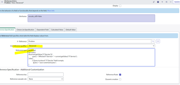

Hi Vishal, thank you for your fast reply!
I have attempted this but I've hit some issues. Note, I referenced the incorrect field so I have amended your script. Instead of 'IT Service' it's actually 'Affected IT Service or Application'. The script I used following your help was:
javascript:
var query;
if(current.getValue("Search IT Service or Application")){
query = "Affected IT Service=" + current.getValue("Search IT Service or Application");
} else {
// Query to show if "IT Service" field is empty
query = "your cutomized query";
This is how it is displayed in the Reference Qualifier:
The below shows the incident form and the problem lookup list when the script is in action:
See below reference screenshots too, these show the ServiceNow service and a test problem open for it too:
Thanks again.
