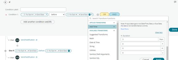

Hi.
Is it right to put this condition for : Date is 3 days ago or there is a correct way to do this in flow designer?

Hi @Dizy M ,
You want to compare Send date is 3 days ago from the current datetime right??
if you comPare it above , it would always return false since its comapring as Send date < 3+send date
Create a flow variable and get the current datetime
result = new GlideDateTime();
result = result.toString();
return result
Compare Sand date with this flow varibale by substracting 3 days
Hope this helps.
