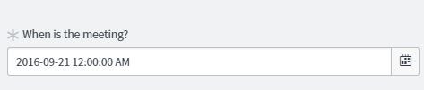

I found a strange issue in my Service Portal. When accessing a catalog item from the SP, I set a date/time field with a random date and time. When I submit it, the date is kept the same, but the time is always set as 12:00:00 AM.
Example:
Setting the date:
Date as appeared in the variables section of my RITM:
When I create a request from the normal UI, this doesn't happen. In that case, the date and time are the same I set in the form. I tried to google this issue, but I didn't find anything like it. The instance is in Helsinski, patch 3.
Does anyone have any ideas?
Thanks in advance!

Hi Gary, SN support end up finding that someone had previosuly modified the Date/Time dictionary type, and by reverting the change, the issue was fixed. This is what solved our issue.
