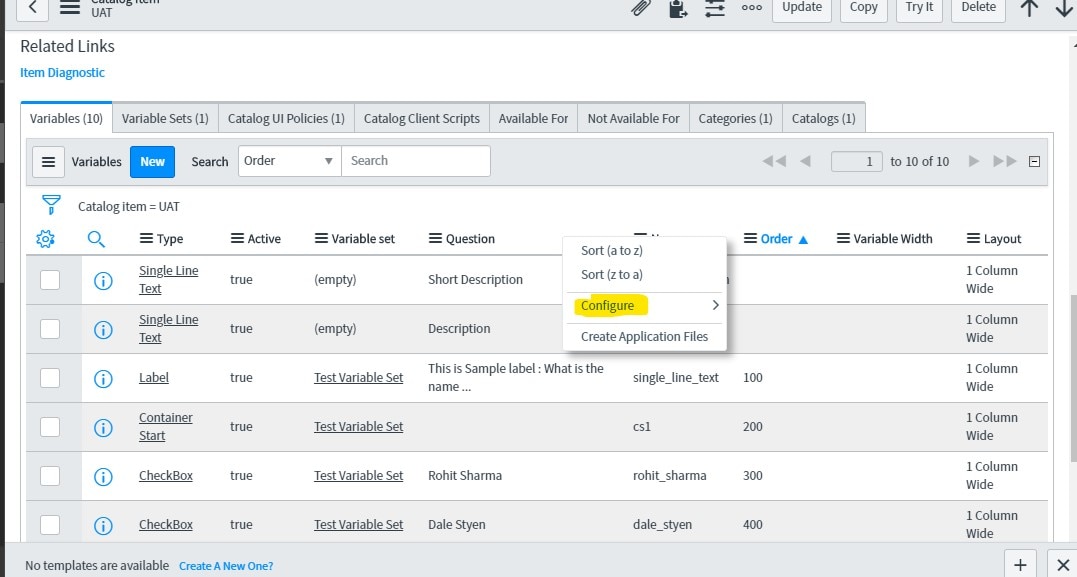

Hello LG,
I have same requirement but for another table: Check out the below screenshots,
1. right click between column, click on configure ALL.
2.  Go to Styles and click on new as below:
3. Create new style as below:

Hello LG,

Hi Abhishek Gardade,
Thank you for the detailed answer.
That doesn't really solve the problem as there are many tables and fields and I don't want to change them one-by-one.
I am looking for a way to make it the default behaviour and imeddiately inherited to all number types such as String type default style is left-alignment.
Hi LG,
As far as I know, I think the only option to change the styling is as suggested by Abhishek.
As you can see, in list layout, all the cells have the class as "vt", and the styling is added as an attribute to the cell. So, we can't override that using any CSS, as we won't be finding any specific CSS selectors for integers. The HTML is rendered with that styling using ServiceNow's internal processing logic, and I guess it is not configurable.

Hello LG,
for which tables and table fields you want to make such configurations?
You can write a Fix script or scheduled job to create new styles for specific fields and then update the alignment values for fields,
I recommend you to run this script per table.
