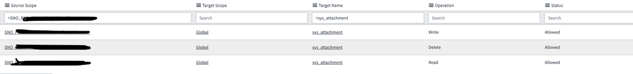

I have a script in a privately scoped application that is supposed to delete a specific record from the sys_attachemt table, but for whatever reason it is not working. I confirmed that I have the proper cross-scope privileges to delete from the table, and the logs are showing the "INSIDE DELETE' message. The only issue is that it is not deleting the record.

Cross-Scope Privileges:

08-08-2023 11:19 PM
Can youOpen the table of "sys_attachment" check "can delete" checkbox and try again!
I have tried in my PDI and it worked!!
