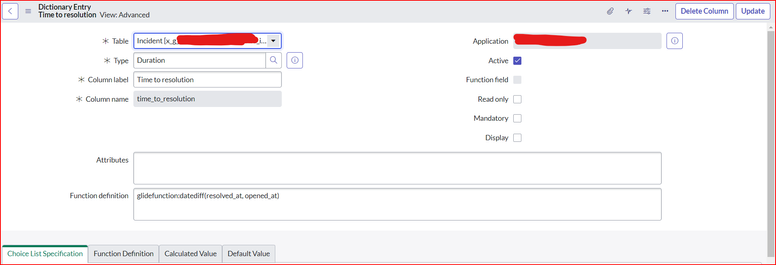

I have a dictionary entry of type duration for a custom scoped application table. This dictionary entry intends to find the difference between two DateandTime fields.
I created the same and in the Function definition I entered the code given below:
glidefunction:datediff(resolved_at, opened at)
However, the field shows 0 days 0 hours etc. Is there anything wrong with the code? Does this not work on old/pre-existing records?
The screenshot of the Dictionary Entry is given below: (same image is attached as well)
Hi Navaneeth,
Please change the code to
glidefunction:datediff(resolved_at, opened_at)
And in your screenshot the function field is not checked.
Please configure as same as the below screenshot.
Result:

Hi Navaneeth,
You are right, it won't reflect for the old records. You may need to run a background script or fix script to update for old records.

Hi  Navaneeth1
As we can see the Functional Field Code is correct and For this "Does this not work on old/pre-existing records?" -- You need write a Background/Fix Script to update the old records.
I just checked and it's not working on new records as well. Could you please let me know if there could be any other reason for this not to work?
