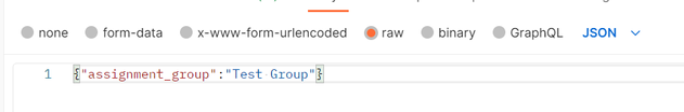

On the incident form, to populate the 'Assignment group' field, if I use the Name of the group in postman/rest API explorer, it works fine and udpate will happen.

On close inspection of the REST API documentation, you'll notice you can use a flag to control whether to set field values using the display value or the actual value. The flag is: sysparm_input_display_value
This is however set to false by default. I would say this behavior will depend on which API you're using eg: Table API vs other vs your own scripted REST API. There's a lot of merit in using display values (where unique) as external systems will not always have access to ServiceNow sys_id's (not to mention the overhead of maintaining them).

In REST API explorer, this is what I did (tried updating an Incident) with below 4 combinations
Finally, in each of the above case, the incidnet got udpated with actual values for both the fields..... I dont see any difference in setting the field "sysparm_input_display_value" TRUE/FALSE.
