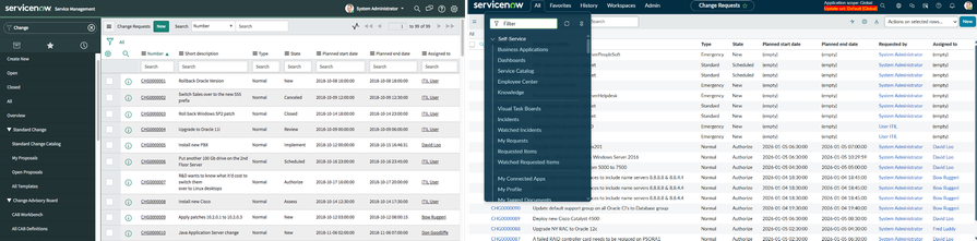

Are both of the UIs in the images Core UI?
If not, if one is Core UI and the other is Next Experience UI, what was the relevant difference to warrant a change in the name? Also, what can I call both of them collectively to oppose them to the Workspace UI?

1st thing you mention about the Homepage view - yes ServiceNow updated there view from I think San Diego Version, now user can use any of the view - Old view also known as UI-16 and new view known as Polaris View,
In new view it has more User friendly, you have separate section of Favorites, workspace and history, the look and feel of list, form is also updated.
All though you can also switch your views from system properties, navigate to all < sys_properties.LIST
And search for "glide.ui.polaris.experience" and make the value as false. Refresh the home page you will navigate to old UI
