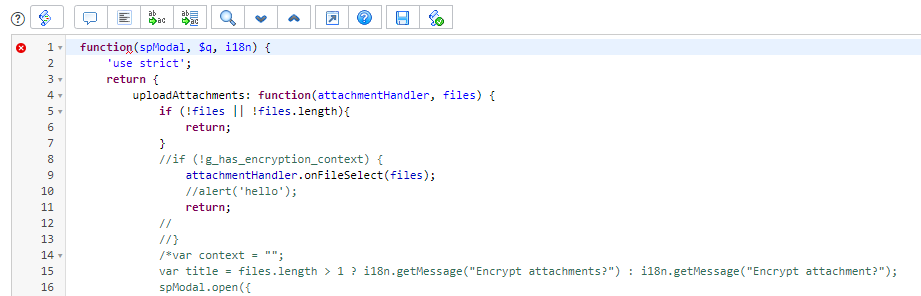

Hi
To disable the attachment encryption prompt on the portal, you will first need to follow the steps outlined in KB0862609. Once you've completed steps 1 through 5, you will need to open "spAttachmentUpload" from the "Angular Providers" table in your instance. Comment the lines shown below and save the record.
After doing so, you will no longer see the encryption modal window appear when attaching a file to a catalog item.
05-21-2021 04:35 AM
Hi
I have done the import and modified the script as shown below.
When I save the script it seems to work for some minutes... then the pop-up shows up again?
Sometime it works sometimes it does not? Can't find any pattern in this.
Any thoughts on this one?
It lives its own life, apparently...
06-21-2021 07:41 AM
Hi Johan,
It looks like you are receiving the modal window on the standard ticket page. The ServiceNow KB article only instructs to add the angular provider on the SC Catalog Item widget but this does not affect the standard ticket page. To prevent this, go to the "Standard Ticket Attachments" widget and edit the angular providers related list and add "spAttachmentUpload". Credit to Mark.bailey@abm.com for identifying this gap in the ServiceNow knowledge article.
