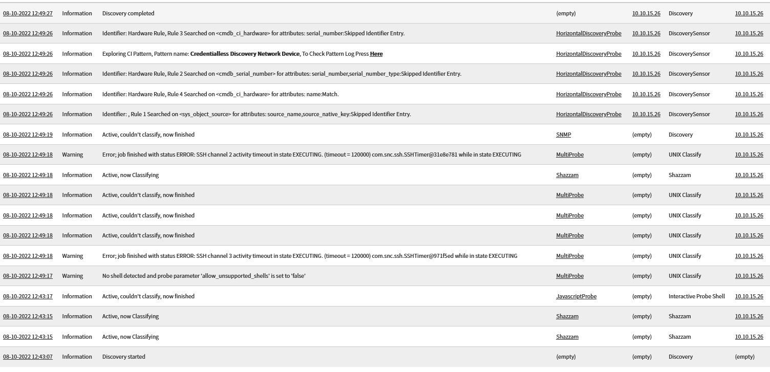

Trying to run Discovery on our Fortinet APs but I'm having trouble. The Discovery doesn't seem to be receiving much info from the device. Did an SNMP credential test against the device and that was successful. Here is some logs below. Any help is appreciated.
The Device results of the Discovery.
Here is the Discovery log
And the ECC Queue

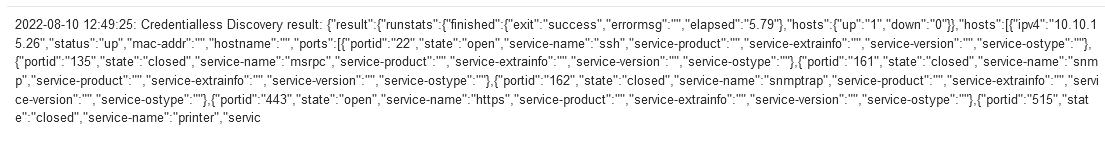

Horizontal log is showing ports 161 & 162 (SNMP) are closed
Shazzam probe shows it's open
What are my next steps in troubleshooting this?
