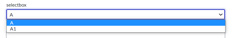

Before I write a script to do this, I was wondering if there is an OOB way of showing the text of a catalog item variable instead of the value on a form.  I've been looking around for a while now and can't seem to find a way to do it OOB, so just want to make sure I'm not missing something before wasting time writing a script for it.
Catalog Item Variable options:
I need this to show the text instead of the value:
So In your record producer, value is gettng mapped instead of label
Since you are using map to filed from you record producer variable, your choice value is getting mapped.
Remove 'Map to Field'  and use producer script with below logic
current.u_var_strategic_alignment = producer.u_var_strategic_alignment.getDisplayValue();

The select box is showing the text correctly on the Catalog Item, it's the form on the backend that is showing the value.  Text is correctly set as the display value for the question_choice table.
Can you show the back-end form field dictionary?
how are you mapping the variable value to field?

Sure, it is being mapped by using the same value for it's name as the field it is mapping to.
