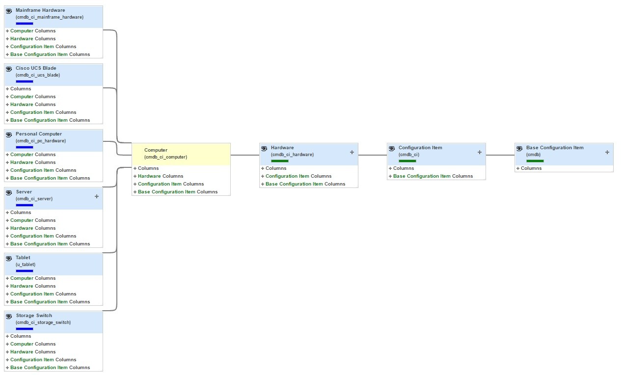

On your MAC example, all of these belong to the Computer class. These exist within the cmdb_ci_computer table which extends (aka 'inherits') from Hardware (cmdb_ci_hardware). Companies will often decide to classify their computers within the Computer table/class because it has all of the properties that they need, but they could also choose to classify it within a more specialized table for Personal Computers. If that's not know, you could create an additional specialization for your MACs by either extending a new table from Personal Computers or from Computers, depending on how you as a business want to manage it.
So, as you can see a class is represented by a table definition... and the schema of it's relationships (like the one shown below) it's available on the record of the Table definition [navigate to Tables & Columns in your ServiceNow Navigation window].
