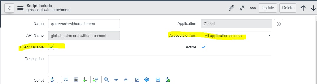

Mihir Mohanta
Please check "Accesible from" field value is All application scopes or not in the script include you have written.
