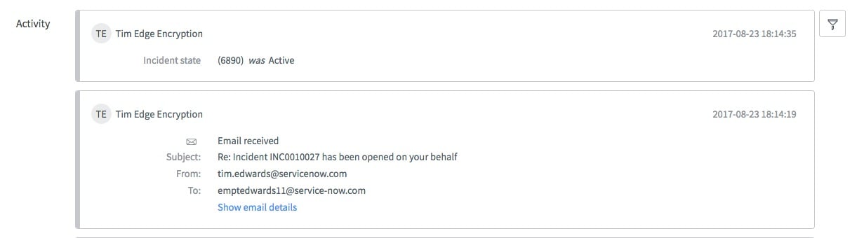

As I understand it you want an email to appear on he Acitivty Log without adding the email body contents to Additional Comments (or worknotes)? As you've found, for an email to be associated with a particular incident and appear on the Activity Log the relevant Inbound Action needs to actually change something on the incident record.
I tested this and found it's good enough to change any field, so you could add a simple integer 'flag' field to incident (e.g. email_recieved) and have the Inbound Action keep flipping it to a different random number to ensure the Inbound Action always has an update to do.
For my test I used this Inbound Action script (I used the state field and set it to a random number):

I get the result you see in the screenshot, no addition comment is added but there is a notification about the change in the state field. Hope this helps.
