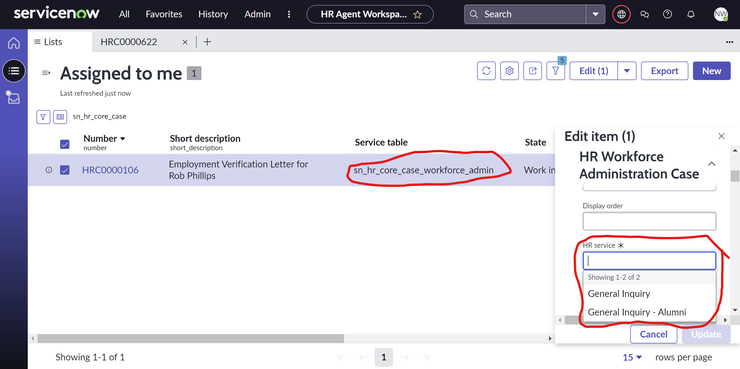

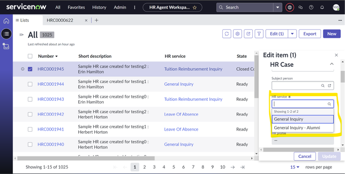

I am very happy to see new agent workspace however there is one issue for which I am struggling.
I wonder if every one is using edit action for selected records, its semes pretty a useful. but when I am trying to change
the HR service; the reference shows only HR Case COE Hr services. is there any configuration that will allow to select all the Hr services form all COEs.
attaching screenshots
Thanks for your support

Thanks @Sandeep Rajput for sharing your thoughts.
As I was having the same perspective earlier. But please find below screenshot. Though Original case is in different COE, It is still showing the HR services from HR Case COE. I am really not sure if this is expected behaviour or a configurational Item.
