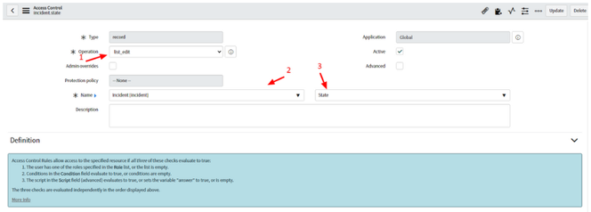

Hi @MStritt ,
Ok, then you need to verify if an ACL is in place - example shown below:
